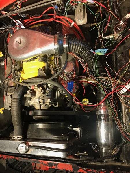

Spectre makes this one that should work. I believe some jeeps had a low profile hat too that you might find in the bone yard. You could then use an inline air filter. I will try and find that part and post it.

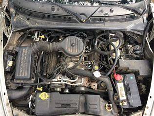

Magnum Durango, Dakota and maybe others (Jeep GC?) air bonnet, hose and a remote filter- use a cone shaped Spectra/K&N/EBay or whatever filter mounted wherever it suits you. "Boneyard Cheap".
