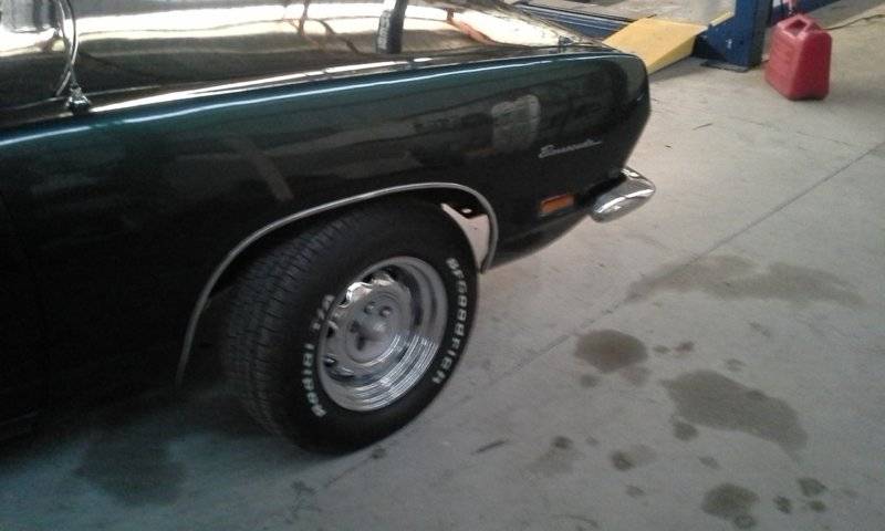

So I raised the torsion bars to gain ground clearance, and the front end was wandering, so I took the car to an experienced shop. My $69 alignment turned into an $800 front end rebuild. I went to pick up the car and he told me he got everything aligned, but I would need to get a spacer for the drivers side. When I got the car home I found the drivers wheel rubbed the upper ball joint, so I got a spacer for it. When I took it for a spin I discovered the passenger tire was so far forward in the wheel well it rubbed the fender. So my question is did I take it to a bunch of yahoos and I look for another shop, do I take it back and give them another crack, can I adjust something at home and enjoy the car. Whacha think?

Sounds like one strut rods too tight bringing it into the fender.

agree with above if that is the side they changed the strut bushing on
agree factory wheels should not run on ball joints, however, I see that they are chrome, which suggests they may be custom spaced.
