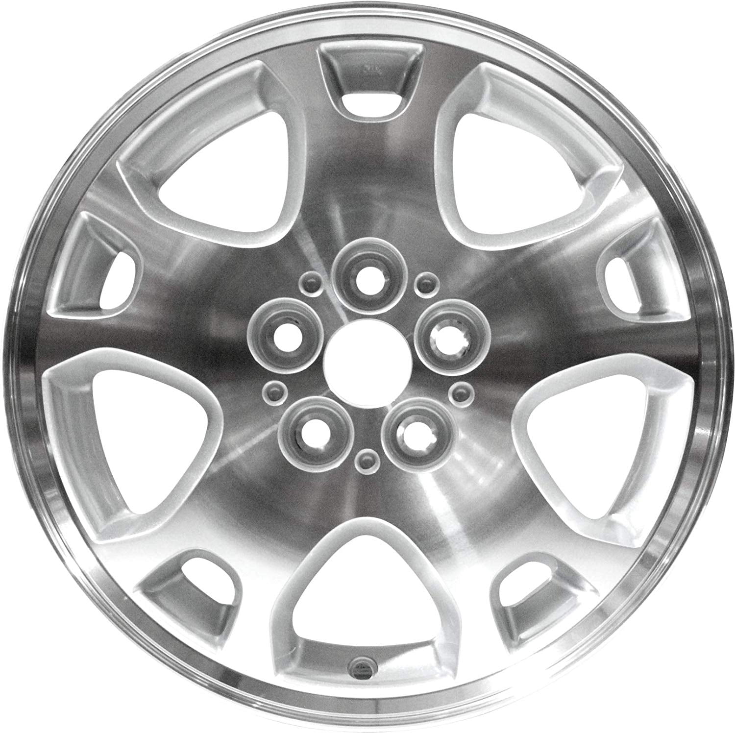

I had no idea this was a thing! Is he local to us? Most of my Neon rims are alloy and I need the clearcoat refinished because it lifts and then they leak.
Yeah, he lives in Raymore. He does mostly cosmetic repairs for high end dealerships. Not to be rude, but I doubt he’d be interested in stripping clear coat on Neon wheels. It’s a lot of work. Usually we send wheels like that out for stripping and powder coating. Costs $1000 per set.
Will require regular upkeep.
Strip, Sand, Polish with Black Emery and White Rouge. These were free and my car trailer needed rims and tires.
Does consume time but is almost free
