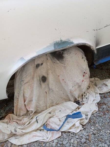

Am I crazy for doing this on a 65 Barracuda ?
You may want to use a different primer . I just used rust reformer on the new metal too because I didn't use the rust reformer before I started to install sheet metal. It'll be okay but ....... and I also used a fibered bondo as some one here suggested . Only out in the middle area because I wanted to use up my original to bond the screen at the edges. I may use the original to finish coat if I don't like the way the way the fibered sands and spreads , Haven't checked it out much yet.
I bonded the screen to the inside of the body panel accesible through the trunk at the top of the screen . Very important to get the screen bonded around the edges before putting much pressure on the screen I'll finish bondo in there after I finish the exterior. I wiped down a piece of thick cardboard with WD40 to stick behind the screen till I got the outside roughed in. It came right out after fiberglass dried and I'll wipe down the bondo in there with some mineral spirits before finish coating that.
I have metal at all edges and this seems pretty stout .
Was going to suggest Gorilla hair Filler & galvanized gutter screen, which looks exactly like what you've used. The WD40 as a release agent is great idea.
A thin nylon type cloth can be used for that, called a release cloth, removing it while Filler still green. It leaves a great almost finished, smooth , but rough surface you can bond to.
Great for repairs needing a finished look. & no WD40 needed.
Real release cloth is used inside boat hulls to give that finished look right out of the mold(Layed up not Chopgun). And keeps repairs from looking lumpy. A few yards at Fabric Store is cheap.
Gorilla hair easier to work green, of course, and you need a skim coat for totally smooth finish.

I stayed with the fibered bondo till I was pretty well coated in and then switched to regular bondo. I clamped a metal yardstick on the bottom edge where the body and trunk panel meet. ( oil it lightly or if you forget like I did, pull it off after you fill that area, and clamp it back on )
The factory edge showed spot welds and was wavy under there so I'll sand a little and transition into that after body panel is ready to paint. This metal edge from the yardstick makes things so much easier to work from and leaves you a perfect edge at t the bottom of the panel . Not really much build up here if placed at the correct spot.
Pic is also showing the metal edge in the wheelwell . With this in the correct contour of the body panel it makes it so much easier to form the fiberglass panel working off the metal edge.
Lots of stuff coming together at the front of the bullet at the wheel opening so have to be careful not to get too much fill causing a lot of sanding. I probably went over this area 3 times to get the contours correct without bringing much bondo out on the original paint.

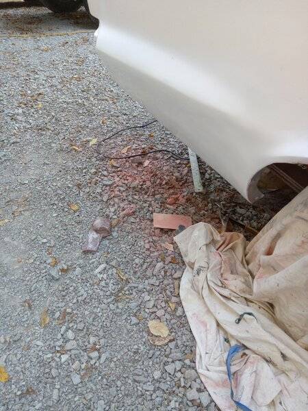

I got the this quarter ready to paint today and started to mask. It is very smooth even if it doesn't look it.
I got the passenger quarter painted and taillight and trim installed. Down to the deck lid and I found someone tried fixing it before. They beat the area in and welded a crack that I outlined with a pencil to show approx where it was welded and cracked.. They sprayed a little black on it and stradled it with a piece of light iron. Which made the trunck stick up .
