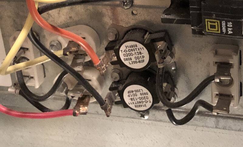

My "goto default" argument against Mopar bulkhead connector terminals used to be electric furnaces. "In a previous life" I serviced HVAC/R and lots of heat pumps and or electric furnaces. They use those 1/4" spade/ flag terminals at the heating elements/ protectors/ relays in the controls. The typical 240V electric strip is nominally 20-25 amps so that is what is on those and THEY USED TO FAIL FAIRLY REGULARLY so if they are failing at only 20-25A you can imagine how under-designed they are at say, a 55A alternator
Here's an example of an old school electric strip unit from "back in the day ish"
That looks REAL similar to our "now-ish" strip unit.

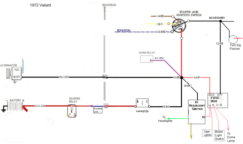

Looks like you found at least one short in your other thread begun on Saturday.
Here's what's going on:
The ammeter is a part of the battery power feed. There are two different wire colors used to insure the ammeter reads the correct direction.
When the wires are connected, black is hot, just like the red is hot.
As you discovered, the black wire is connected to the MAIN JUNCTION. This is a WELDED SPLICE.
Everything connected to the welded splice is hot.
The main junction joins the two power supplies (batery and alternator) to the the main feeds as shown in the drawing below.
Not everything is fed through the fusebox.
With the key off, there should still be power at the fuses for the dome light, brake lights, tailights. There should also be power for the headlights (no fuse - circuit breaker inside the headlight switch).
The fusible link is a last ditch protection measure against battery shorting to ground.
One more big clue and caution.
The ammeter shows current flowing in or out of the battery. In other words battery charging and discharging.
Its another useful tool.
Its calibrated roughly 40 amps to 40 amps.
Anything close to 40 amps either way is DANGER DANGER
