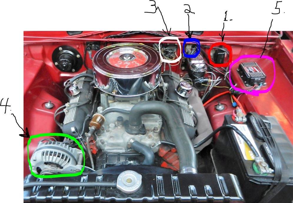

-- Amp meter jumps with lights on or off.-- Pulled the bulkhead connecters apart and cleaned them, did the same to, all of the connections on the gadget next to the bulkhead connector. Tightened all connections, real tight. -- Same result.
Battery charges OK. What can, potentially, happen, if I ignore the jumping amp meter, and drive it in the day light, only ? -- Screw up _____ ? -- Fire ? -- Other ?
