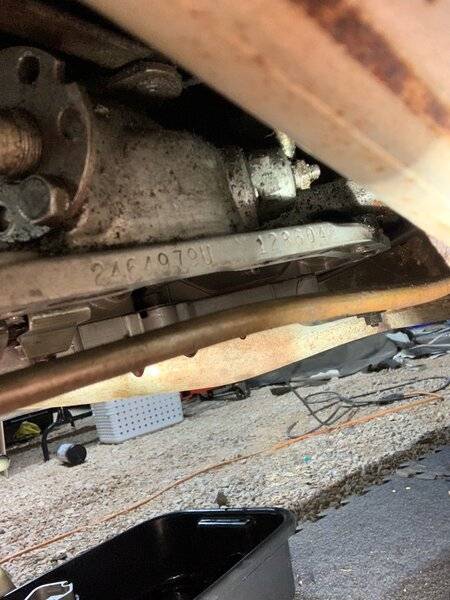

The 64 Dodge Dart GT Convertible I picked up has 2464979U stamped on the transmission, which according to Tom Hands workbench shop manual is a small car V8 727. See image.
But the pan is clearly the shape of a 904 with one diagonal corner. See second image.
What is the discrepancy?
The car has a non-original 318. Can you guys help me get started on this project with identifying what it is that I'm working with?

The pan shape SHOULD be 100 % correct
There is a possibility that it is a coincidence that 2464979U is a partial VIN or sequence number.
Thanks for the immediate response! I feel like going with pan shape is the best bet too. I'll get some pictures tomorrow, and make sure I've read ALL the numbers correctly.
That trans should be a cable shift with a rear pump . They called them the little torque flites back then.. Actually all 904's came behind 6 Cyl. engines. Small V8's after 66 were 999's and 998's. Everyone calls them 904's though.
Get some photos of the numbers, many times 8 and 3s, 6s, 9s can be mistaken.
The number in the book might be a misprint
2464979 is the correct part number for a 1964 dart with 273 engine. It should be a 904 transmission. Check the shape of the pan to be sure.

Transmission stamp: 2464979U 128604

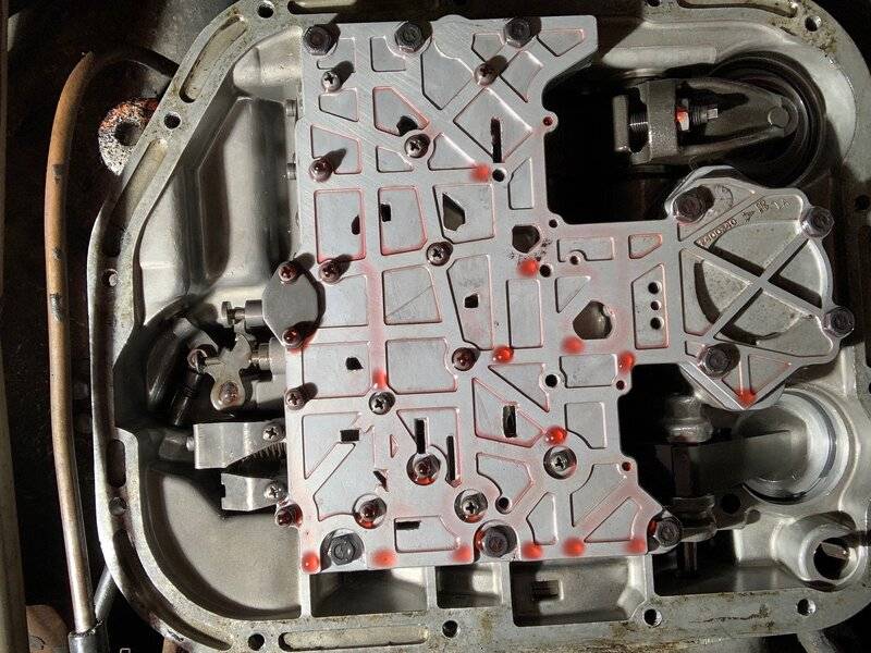

Valve Body: 2400340

Valve Body: 2400340
Not to confuse you, but I have multiple valve bodies from 1964 727's with the same casting numbers as you show 2400340..... Not sure if they actually directly interchange between 904 and 727, or if any of the spring pressures are different, etc. Just a little insight for your future reference.

The number 2400340 is not the part number for the complete valve body assembly.It is only one section of the valve body.This piece of the valve body was used on both the 904 and the 727 in 1964 and 1965.
