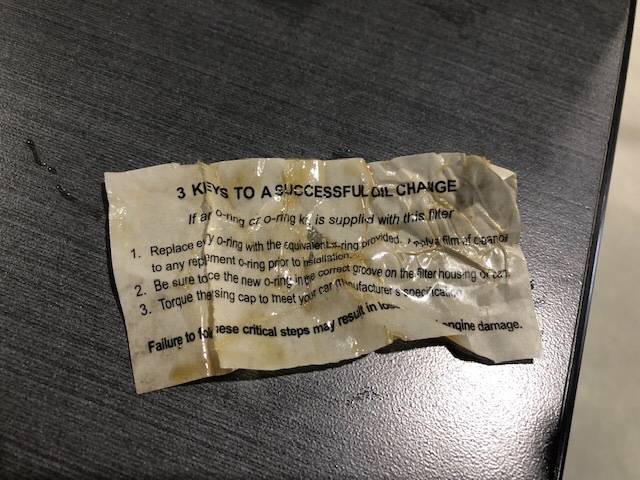

Here is another reason to stay clear of jiffy lube. Had a caravan come into the shop yesterday with a massive oil leak. Oil was changed 100km ago at a local quick lube joint.Pulled the dipstick outside and added another 3 litres to bring the level up so I could read it. Quick to diagnose the leak as a torn o ring at the cartridge filter cap. Was surprised to find this filter replacement instruction sheet also stuck in beside the filter, obstructing flow.
