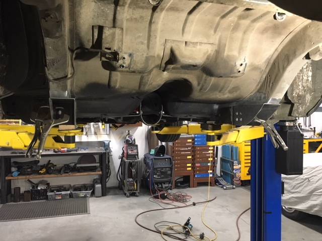

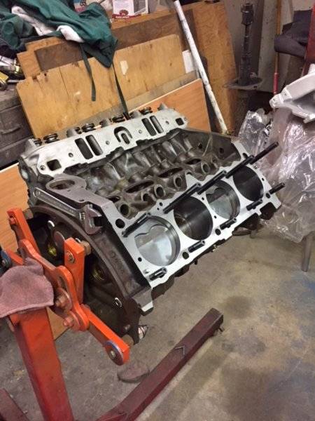

Ok guys this thing has been sitting long enough! My wife, (girlfriend at the time) bought me this car for a birthday gift the summer we graduated high school. We all have been through a lot and it’s been in our engagement photos, wedding photos, baby announcements and so on. Lots of memories with this car and my family, as well as spending time with my dad building it and making the changes throughout the years. It was last on the road on September 13th 2016. That’s the day I lost the engine in this thing at 1600 miles. Long store short got some heads built a motor and it ran great best of a 12.05 @ 111mph. But it didn’t last long when a valve retainer failed in the heads I had done. Guy didn’t want to stand behind it and I was starting a new carrier so it sat. Moved from storage to home and now finally showing it some love. I am putting together a basic stock 360 with good rings, head gaskets and studs and gonna hit it with some boost. This may start off slow and I hope I don’t bore you guys too much but at this point I have all the wiring stripped out of the car, and everything out of the way to move forward on the mini tub. I’ve got a buddy of mine helping me with some of the fabrication so I’m waiting to get it over to his place to start the cutting. Here’s a couple photos of what it was last time it was on the road.

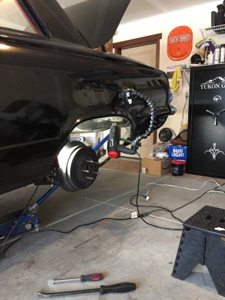

Finished up scraping all the undercoating out of the wheel wells. A head gun and gasket scraper and it wasn’t too bad!

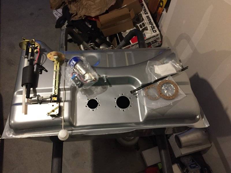

Got the new fuel tank the other day, finally got around to un-boxing it and taking a look. Really happy so far with it. It is a tanks inc tank for the early a bodies, direct swap with a in tank 455gph and return all ready to go!

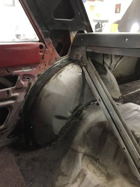

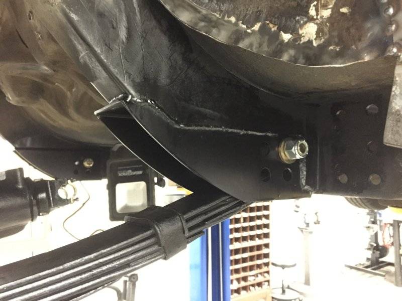

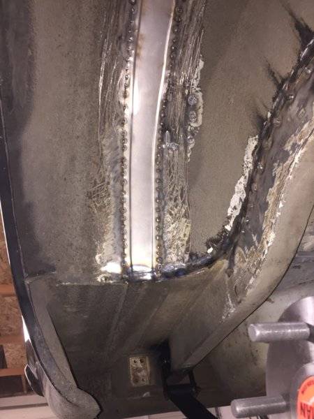

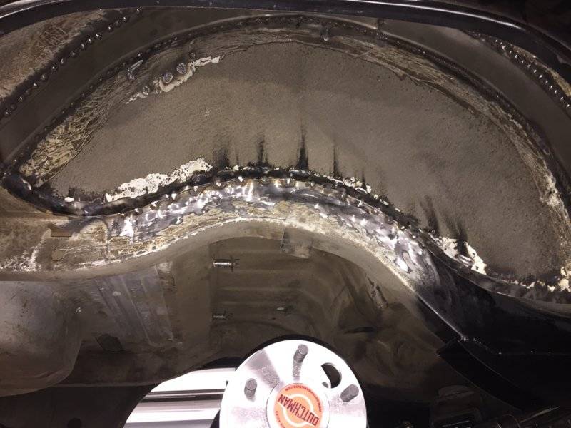

Ok guys I’ve got a little catching up to do. Got the engine back together almost ready to test fire bolted the spitfire headers on reversed to see if they would work. It’s doubtful the way the drivers side is pointing right at the motor mount I’ll take another look once it is sitting in the car. Also got the mini tub done by a good friend. We’re moving forward slow but steady.

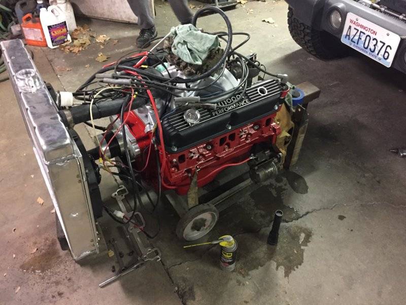

Wow how time flys, still getting progress on the valiant but it’s slow. Running a business and the family seem to take up a lot of the “spare” time. Ran fuel lines started on the battery relocation. Was probably 30 mins from breaking in the engine when I found a small hole in the exhaust port on one of the heads, so working on getting another head worked up to put it back together to make some noise. Sent my converter to PTC with the changes I’ve made to the car and now going to be running boost they made some changes and swapped out the front of the converter to work with the new setup.

Thanks it’s something we kinda threw together, didn’t want to try and break it in on a new wiring kit and Fitech in the car thought that points and a carb would be easiest to get it started and broke in. The converter is already back, they were not really detailed on the changes they made other than making a couple changes to work with the boost and changing the front half of the converter. It was $250 plus shipping for the changes. Figured now was the time instead of putting it together and not being happy with it. As you can tell I’m not in any kind of rush to get it going. Lol. Just hoping to get it done by spring.
