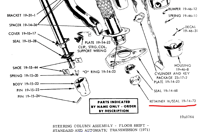

Interesting that you say you've never seen one with a lower bearing. Appreciate that input. This car is an original Demon 340 with the console shift for the 727 and I do know this is the original column in the car. Yet it did not have any lower support bearing/bushing at all. It obviously has the upper bearing by the steering wheel but then it was just connected to the steering gear box via the standard coupler. So I wonder if it ever did come with any type of lower support bearing/bushing?
The 71 FSM shows some type of "Retainer w/ seal" but does not really show what that may be. From the pic of my column, you can also see the little wire "spring clip" that goes around the outside of the column tube near the bottom. I don't see that in the FSM either except for the column-shift cars.
