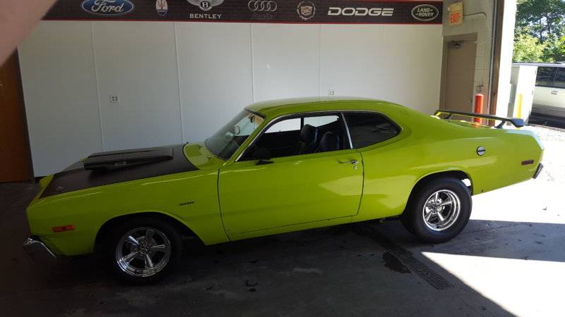

I went to Right Stuff rear disc on a Dana 60 and my old wheels no longer fit . I had to buy whatever was available in town that day. This is what I got, though I wanted 15", not 17". By the way, it is a 73 Dart Sport. The wheels look great and fit great.
Rears: PACER 177C 15 x 8 WHEEL - -22 OFFSET 3.67 BACKSPACE
Front: PACER 177C 15 x 7 WHEEL - -13 OFFSET 3.49 BACKSPACE

looks very nice
