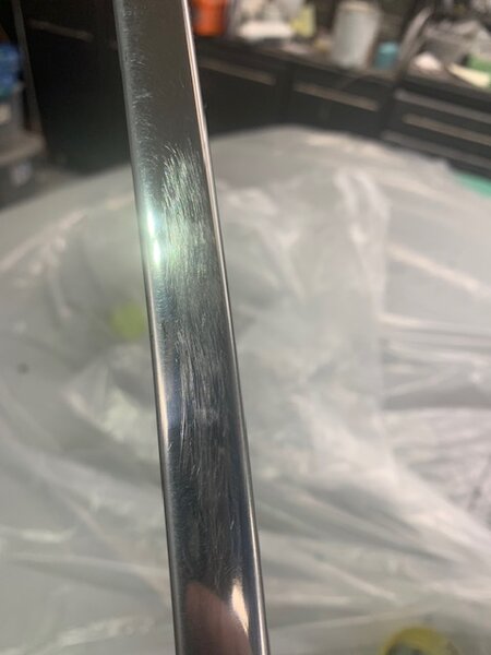

I got the worst piece in pretty good shape for polishing I think...I'll see what it looks like when its shiny again. I just used a piece of 3/4x1/2 wood as a backing piece and parts of my vice and some flat bar to get it straight and get the dings out. There was a bend that I straightened by clamping the trim between 2 pieces of the wood in the vice. The trick is to knock down the high spots and raise the low spots such that you can knock them flat with a file from the top side. The hardest part was getting all the low spots high enough that they could be knocked down. I then hit it with 80/180/320. It goes pretty quick. I'm onto finer sanding and polishing now. I used to have a bench grinder but I used it so little and it was in the way. Now I'm on the fence as whether to buy a dedicated polisher or just get a bench grinder and mount the polishing wheels. At least I would have both in the end.

View attachment 1716369018View attachment 1716369017View attachment 1716369019View attachment 1716369020
One thing...
Tap out as much of the dents as you can.
Reduce the amount of filing to a minimum as this trim is not very thick and its very easy to file through it.
In pic 1 right , those little lumps should be tapped out.
I made that mistake and went clear through the trim piece I was working on.
Funny thing...
It was exactly the same piece in your pic!!

Yes I spent most of the time tapping out the low/high spots. I probably spent an hour on this one piece. Its a good thing the rest is in much better shape. Hopefully I can just sand it 1000/1500 and go to the polisher.
