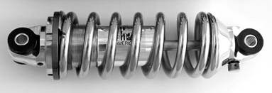

Coilovers aren't magic. They are springs and shocks combined into one unit. That's it. Coil springs are not superior to torsion springs, and shocks are shocks. Both the Mustang II coilover design and the torsion bar suspension design are unequal length A-arm suspensions. There are some geometry differences between those two examples obviously, but for the most part they are the same basic style of suspension. With the aftermarket parts now available for the original torsion bar suspensions, you can tune the geometry just as well as you can with a coilover set up.

Alden Eagle coilovers/ #654 (pair) complete assemblies w/ 450 lb springs.................15.1 lbs

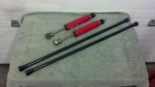

Just Suspension 1" torsion bars:................ 17.0 lbs
Bilstein RCD's x2:......................................6.2 lbs

So, starting from where Denny left off, I weighed some things. Now, full disclosure, I just used a cheap digital bathroom scale. I weighed each item a couple of times and took a bit of an average, but really anything within a pound of these measurements wouldn't surprise me. I also used a 73-76 /6 K because thats what I had laying around, but I'd wager a V8 spool K is within a pound or so, only the engine mounts are different and not much really for total metal used.
OE manual steering box:..........................12.4 lbs
OE power steering box, large sector:......... 37.5 lbs
Federal pump/pulley/brackets V8:..............15.4 lbs
73-76 spool mount /6 K frame:..................34.0 lbs
Stock tie rods & ends:...............................4.6 lbs
Stock center link, pitman and idler:.............9.6 lbs
Stock LCA's w/tabs, bushings and pins:.......21.2 lbs
Stock UCA's with ball joints:.......................9.8 lbs
Stock strut rods 73-76 w/bushings:.............4.8 lbs
So for the stock K, manual box, and steering linkage my numbers give 60.6 lbs, which is real darn close to Denny's 60.8 lbs for the same items. For the control arms (upper, lower and strut rods) I get 35.8 lbs, which is 2.4 lbs lighter than Denny's numbers. I was a little concerned about that until I saw the stiffening plates on Denny's LCA's in the picture. Makes perfect sense, those are close to a pound each, so pretty close again. For the grand stock total, manual steering, I get 119.6 lbs. That's pretty close to Denny's 118.4, and I used 1" torsion bars.

I will say you can achieve plenty of caster with the torsion bar suspension. I have +7* on my Duster at the moment, and I'm not even running adjustable UCA's yet. Just non-adjustable, bushed magnumforce UCA's I bought used. Peter Bergman runs about +7* as well if I remember right, he has the SPC arms I'm going to next. Before I dialed in my current alignment I was near +8* caster on one side and up to like +8.2* on the other, but with 16:1 manual steering and 275's that was more arm workout than I wanted the few times I drove it with the alignment just roughed in. Just going down to +7* made a big difference. That's not all UCA's on my set up though, I know I picked up some + caster with the poly LCA bushings and adjustable strut rods. I basically set the strut rods as short as I can get them without causing a bind condition, but since my cars are lowered I don't have as much suspension travel to deal with so the bind issue is reduced some, so even tuning for no-bind I think I get a little + caster out of them.
The stock power steering is almost an unfair comparison, that set up is such a boat anchor. I mean, you lose 40 lbs just going to a stock manual set up. But fair is fair, you can drop 70 lbs going from stock power to a manual rack, and the manual rack probably feels a bit better than the stock manual boxes so that probably does happen. But a ~30 pound difference manual to manual rack and a ~35 lb difference borgeson power to power rack is pretty decent. Definitely shows that you don't need to go full conversion to drop some weight.

Point being, you can change just as much geometry and keep the torsion bars.
I think the problem is people over estimate what the need/want. If your never gonna corner faster than .85 of a g no point of building a g machine. Which your not gonna hit too often in your daily driving. Decent tires, heavy duty sway bars and a slight lowering go a long way. But if you got the cash and can't find a better way of spending it go ahead nothing wrong with a tricked out suspension just know it's not absolutely needed to make your car handle.
The Hotchkis Challenger pulled .93g's on the skidpad with torsion bars and leaf springs, and you don't even need all the Hotchkis parts to manage that. But skidpad g's are heavily tied to tire compound. Still, that car is pretty easy to replicate from a suspension standpoint, and you don't have to spend a ton to do it.

Weight savings, roughly 120 pounds total, roughly half-60% of that in unsprung weight,
Four corner adjustable weight bias, something you can't do with the leaf springs
Adjustable rear roll center, something you can't do with the leaf springs
Adjustable pinion angle, something you can't do with the leaf springs
Adjustable front geometry. something you can't do as much with the factory front
Clearance around the headers, transmission(eventually a t56)
Ditched the big heavy factory power steering box for a rack weighing half as much with better feel (IMO)
and a few other minor reasons including finding more options and cheaper options locally for brakes and such.
But thats in my pro-touring build on my dart. My 64 Polara is gonna retain the factory suspension as its a cruiser.
