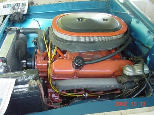

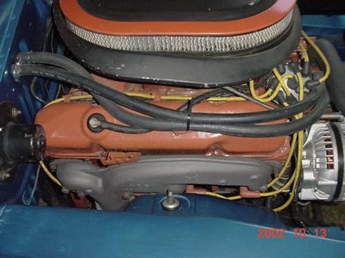

Jun 1, 2015 #1 G Greg55_99 Well-Known Member Joined Aug 8, 2006 Messages 186 Reaction score 72 If you've got this setup, can you post some picks? I'd like to see just how close this is. Greg
Jun 1, 2015 #2 Mopar Tim FABO Gold Member FABO Gold Member Joined Nov 29, 2014 Messages 31,759 Reaction score 34,412 Location vista CA. Do you mean running a 440 in a A body, what year, and using B body manifolds? MT
Jun 1, 2015 #3 G Greg55_99 Well-Known Member Joined Aug 8, 2006 Messages 186 Reaction score 72 1973 A body with spool mounts, 440 using B Body exhaust manifolds. Greg
Jun 1, 2015 #4 J Jim Lusk Well-Known Member Joined Mar 8, 2006 Messages 6,393 Reaction score 3,478 Location Fresno, CA 73-76 V8 k-member modified to Direct Connection specs. 69 B-body HP manifolds. Attachments MVC-018S.jpg MVC-018S.jpg 53 KB · Views: 243 MVC-020S.jpg MVC-020S.jpg 46.1 KB · Views: 174
Jun 1, 2015 #5 pishta I know I'm right.... Joined Oct 13, 2004 Messages 23,884 Reaction score 13,737 Location Tustin, CA The 440 passenger side is tight but its sort of above the inner fender. on a 383, its 1/4 inch from the inner fenderwell in my 65 but right next to it. mine fit great just a tad interference on the driver steering shaft.
Jun 1, 2015 #6 Abodybomber Breaking street machines , since 1983.....:) Legendary Member Joined May 21, 2011 Messages 30,853 Reaction score 7,198 Location Arroyo grande ca Jim Lusk said: 73-76 V8 k-member modified to Direct Connection specs. 69 B-body HP manifolds. Click to expand... Tight fit, looks nice.
