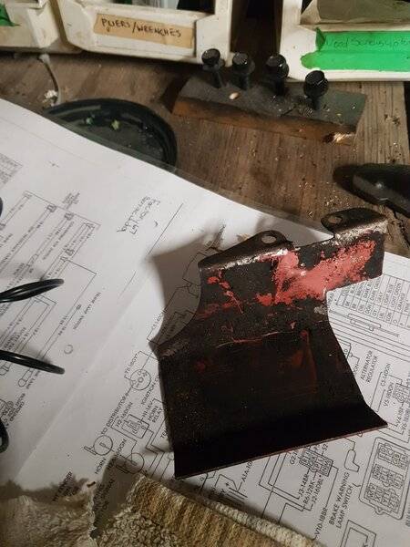

Again, as I was really getting into cleaning this motor up to put it back in, turned out, I think it is a dirt shield? one ear is broke off. I was thinking about putting a WTB on the classified, but not sure if anyone would know it if they saw it. Is this model specific or common on the Six? Makes a whole lot of sense being there though.
Bolts to oil pump to keep splash and junk off the dist.
They are often broken as yours, but can be fixed.
Looks easy enough the average person with the right tools could remake
It's been a while but mine was broken too.
I welded the broken piece back on and if I followed my usual thinking, added a bit of reinforcement.

WOW that’s crazy maybe, i just fixed my sons welled it back on and looks like nothing wrong. Wish i had it near ill show a picture. You can easily make it look new. Jesse guess not so crazy breaks often i see
I just took the danged thing off when I swapped out my oil pump last. Early A's are not kind to oil pump swaps when you aren't pulling the motor out, haha.
Since most of the tab is clean gone off mine, I was happy a member sold me one, should be on it's way already, I will also fix the old one, and maybe even make one more, just in case. Looks like I am becoming a bit of a /6 guy now. Never woulda thunk it.

I honestly wasn't sure if I even needed it, and how the missing portion looked, if it was worth fixing or buying. I am going both directions, both fixing and buying now.

Got it! Thanks Perfect condition, I am going to use it as a templet to fix the old one as well, so I have one for each motor
