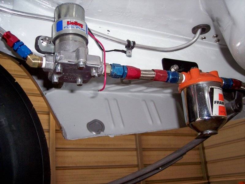

Don't know if this will help you but this is what I did with my 68 Barracuda.
