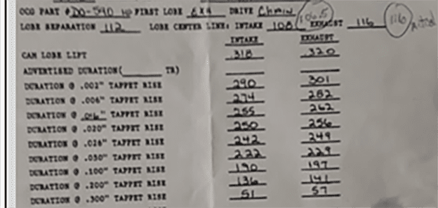

Anyone run this Voodoo cam ?
Well I see 274-282 @.004 which is the Way Crane measures cams
comp/ lunati/ howard at.006 would be under 270 for the intake
no way to know symetrical or asymetrical or whose style lobes they are.
The lunati may not be a big difference and lots of $$$ for a new core
what I'd do is fill out Jones cam request card and pray he'd regrind t for you
or try Bullet
mechanically/ mathamatcaly speaking Jones IR profiles can't be beat
and he can go shorter and get same performance
have you tried the advance / retard drill to see what your motor likes?
The cam card pic isn’t all that clear for me.
I thought the 274/282 was @.006....... but maybe it’s a “4”.
Maybe the OP can verify it for us.
Also, the hand written duration number under that...... looks like .016....... but again, I can’t really make it out.

Sorry ... I was out doing bodywork on the Dart.
Yes that is a .06. Then .16.

if .006 that's a big cam

Blew it up a bit . Still hard to read the increments... .002, .004, .016?, .020, .026, .050...

.004 to .006 makes a big difference

slant's cam card is here post 48
318 budget build
and that card says .006

Cam was degreed and all Timing events checked. You can see my notes on cam sheet.
TDC. Degrees before....degrees after ... Split the difference...

I did take a look at your notes after blowing the cam info up
looks like the intake open is spot on and you did check the timing at .050
many do not and get funny results checking ICL from the nose down
did you find any difference between icl calculated from the timing (middle between open and closed) and a top down measurement- that would tell how asymmetrical lobes are (we do not know what the .004 or .006 seat timing is just the duration)
