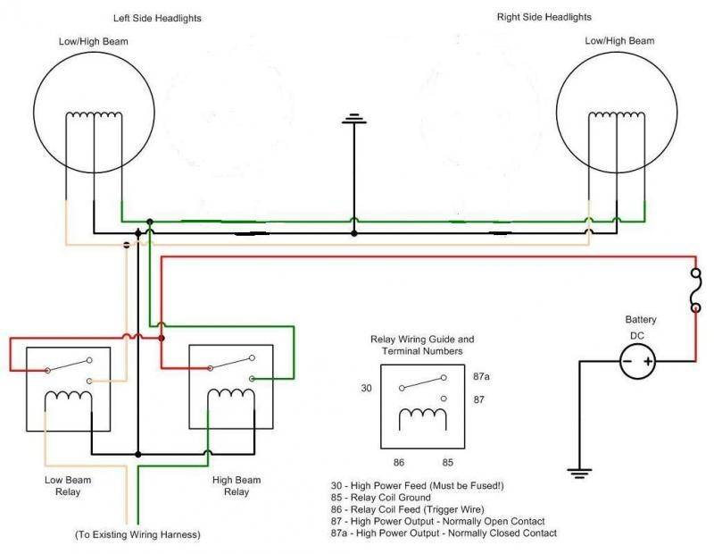

Thanks for the replies. I think I will try the relays and upgraded wires first,then change the alt if I have to. Anyone have a wiring diagram for a 4 headlight system?
You should be able to use the one provided and just seperate the wires since one relay controls the low beams and one relay controls the high beam anyway.
