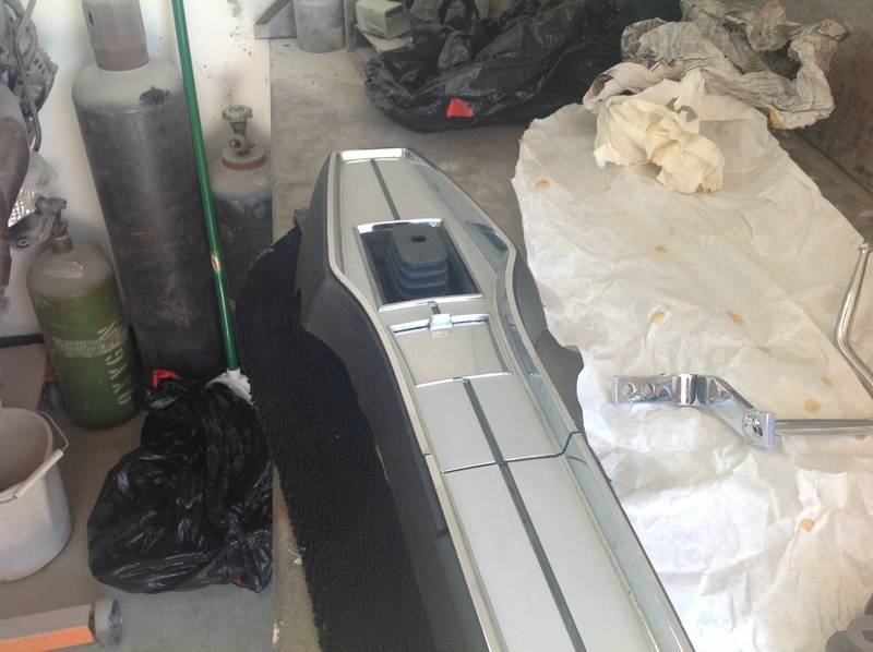

I love that MT console. Is the shifter different or just the stick/lever when using a console? I know on my old Nova you actually needed a different shifter or change the receiver to achieve the more centered offset with a console, but it appears there is only one shifter option for the A body?
There is a "console specific shifter" I believe the mechanism at the trans remains the same but the handle changes.
For 67 to 69, (which is all I know about), there were several options; as to sticks: one for consoles/one for no consoles; and then there's the Inland/Hurst option, each with it's own actual shift mechanism. And then there was the Aftermarket suppliers.
My favorite was the Mr.Gasket Bang! shifter. I still have mine circa 1971. It's a short straight stiff I-beam with 1/2-13 threads at the top. The adapter plate raises the mechanism, and the less convoluted rods are/were a lil bigger than the stock spaghetti-sticks . I moved mine back about 7 or 8 inches, then towards my leg, and finally,raised it up as high as it would go. And then fabricated some beefy rods. Since then, I have never missed a shift.

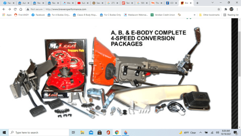

...........what goes into the swap...........
FWIW, Other than parts it's time and sweat. I did my '68 RR out in dad's driveway over a couple weeks while in HS. The auto hump for the B-body remained with a cutout alteration for the shifter and a little messaging for linkage clearance.
The A-body is tighter and the linkage is longer, so I believe you'll need to take the hump plunge. In your haste to get it done, take care to not remove too much floor and make absolutely certain you don't cut out your trans cross member!
The bell crank ball frame mount for these cars are cheesy IMO but should be fine for a good diaphragm clutch set. Try to find the "HD" peddle set if you go the standard mechanical clutch linkage with either the diaphragm or B&B. A "HD" B&B might need some firewall bracing as the spring load is increased.
Probably the most encompassing part of doing the swap is installing the floor hump. Do you have access to a welder and know how to modify floor boards? The ball pivot mount brace needs welded to the inner fender of driver side frame rail. With your 318 it might be drilled and might not be, the use of a Magnum engine roller pilot bearing that goes into the torque converter register is a must if it is not. You'll need to trim the input shaft on the trans by 3/8 to 1/2" if using the Magnum roller pilot.
