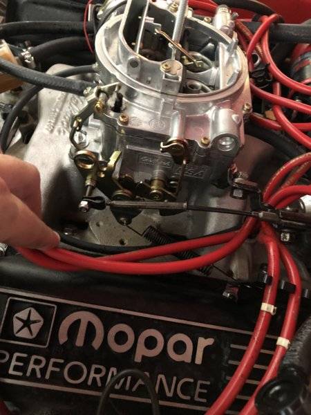

We need pictures. There should be a kickdown rod on the throttle linkage to adjust.

I will post photos later on today once I have the ability. I'm almost certain there's no linkage hooked up. Thank you.
You'll destroy the transmission if that "kickdown" linkage is not hooked up. That isn't all it does. It's more like a throttle position sensor too. Even if the 2-bbl linkage was somehow re-attached to the 4-bbl it probably can't/won't work right without the correct linkage. Read this article, and you'll have a good understanding:https://www.hotrod.com/articles/the-lowdown-on-stock-torqueflite-kick-down-linkage/

Many 2bbl to 4bbl conversions move the throttle hook up location forward. The kickdown, if not corrected, doesn't usually push far enough back to work properly. Edelbrock makes a little conversion piece the fits between the slotted end of the kickdown and to rod that lengthens the rod to make up for the difference. Its cheap, simple and looks right.

Here is the Mopar carb linkage bracket you need for your 1406 Carb.
Edelbrock Part Number: 1481
Get you going for starters, need to rework the 2 bbl kickdown linkage to work with the new 4 bbl.
