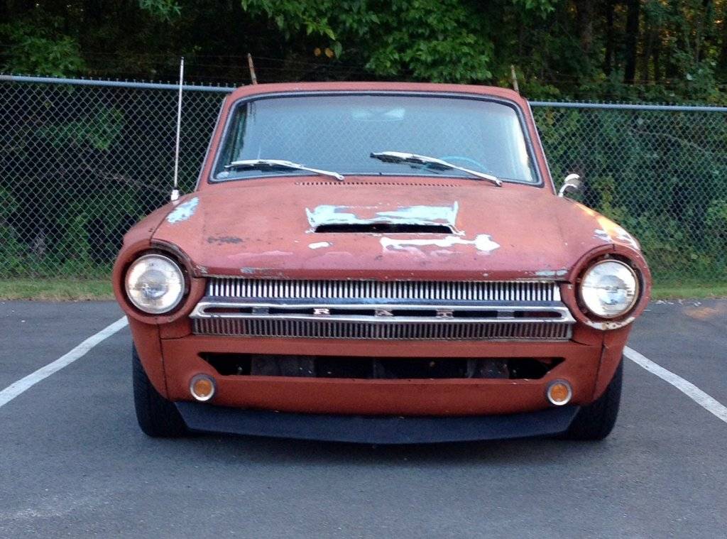

I found an OEM part from a different vehicle that fits on my '69 GTS like a glove. I bought the part new on-line for only $28 shipped.
Here it is test fitted on my car. There isn't any mounting hardware attached yet but you can see from the pics how easy it will be to get it fully mounted.
The details of what it is and where to get it is at the end of the post. But first, you have to see it to believe it!

I'm sure that if it fits on my GTS it will fit on many other A bodies too.
It is the OEM air dam from a 1991 Ford Ranger Compact pick-up truck. The actual part is only $21 plus shipping. Here is a link to get one...

I used one for a '69 Camaro. Although it looks good, it doesn't wrap around the sides. Yours looks factory!

it fits nice but not feeling it man.. it doesn't match the look of the car... now drop the car a couple inches and throw a set of 17-18 inch rims/tires on it and we may be on to something...

There are plenty of bumper spoilers out there these days that would fit nicely (widthwise). A-bodies have a fairly common width comparing to newer/other cars.
Personally I think the spoiler shown in the first post is still about 4" too narrow and is not 'covering' the front wheels. 1-2" lower would look better too imo.
The NOS aftermarket spoiler on my Dart came from a '80s Mercedes and was a nice match for the width of my car;
the Mercedes one looks really nice, too, but what cost?
Considering those are European models with the air dam, don't expect to find any for a reasonable price over here. I found one in really bad condition when searching and it was over $100...and needed a lot of work to ever make it right.
You might pick one up overseas for a reasonable price, but the shipping will cost as much (or more) than the part.
Also, they will only fit on A bodies like the '70 Dart shown without extensive modification to get them to fit a flat front bumper A body that doesn't have a valence under the bumper.
The spoiler I have is about the same distance off the ground as yours. Also, my fenders are narrower than the front tires making a spoiler wider than them impractical. I might be able to go about 2" wider if I could find a different one that fit...maybe...
