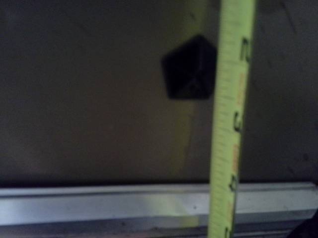

Pentagram measurements.
6 1/4" horizontal from back edge of fender to middle of pentagram.
4 1/4" horizontal from fender to middle of pentagram.
2 3/8" vertical from bodyline(before it bends in)down to middle of pentagram.
Pics suck sorry
Thank you so much. I really appreciate it. The badge will be here this weekend and be on shortly thereafter.
