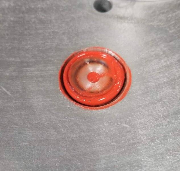

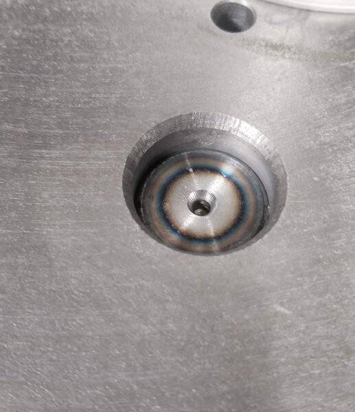

Planned on replacing the seal, putting some rtv on the threads. Right stuff the counter shaft just in case.
Trans works perfectly, anything else I should look into?
Clean up the input shaft and the retainer. Also look closely at the gasket. I have see them weep at the thin area eat the bolt holes. Also make surecthe seal is oriented correctly.
The seal that rides on the input shaft needs to be installed at the correct depth in the bearing retainer. Check it out and when back together put oil in and lift rear of trans to cover the front with oil. Works good.
make sure you use a decent gasket...the retainer presses on the snap ring on the bearing, with no gasket and just a load of sealer it stands proud and you can crack the IBR easily
put some sealer on the threads
but not on the thread that will stick into the internals of the case... you don't want wormy's floating about in there.
