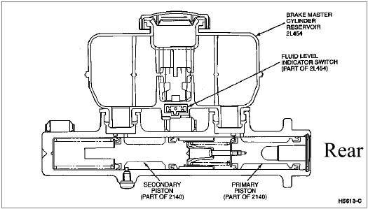

The tip of that bolt goes in a specific place to keep the front piston from returning too far.
It sounds like you had it on the piston instead.
This is a Ford master, but you can see how that bolt stops the front piston from returning further but allows it to go in to push fluid.
You have to push that front piston in a little against it's spring, then the stop bolt goes in.
