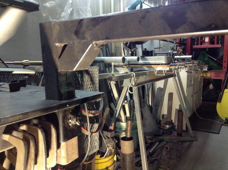

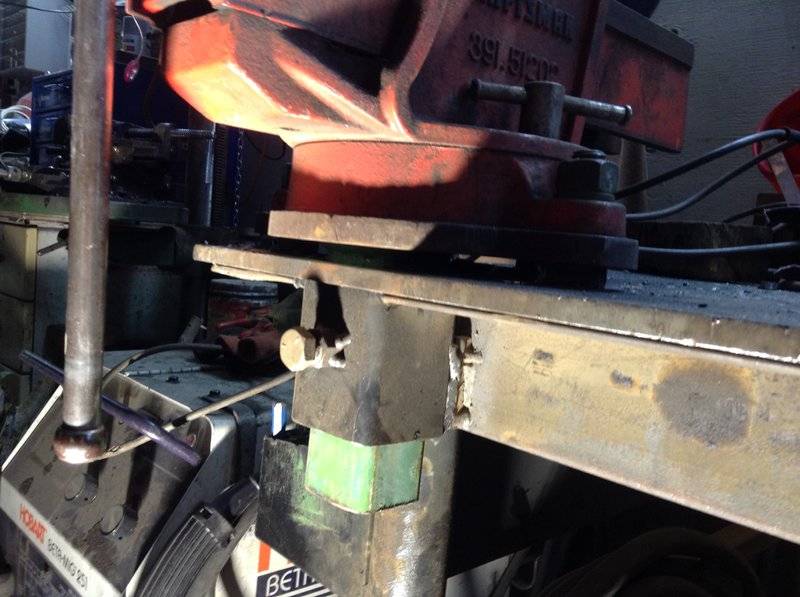

I have also welded a receiver tube vertically into the top of my heavy but mobile steel welding table . It is also tightened with a bolt to keep it from wiggling. On the other end I mounted in similar fashion a bar to support longer heavy items once in the vise. Both are removable and adjustable for height.
