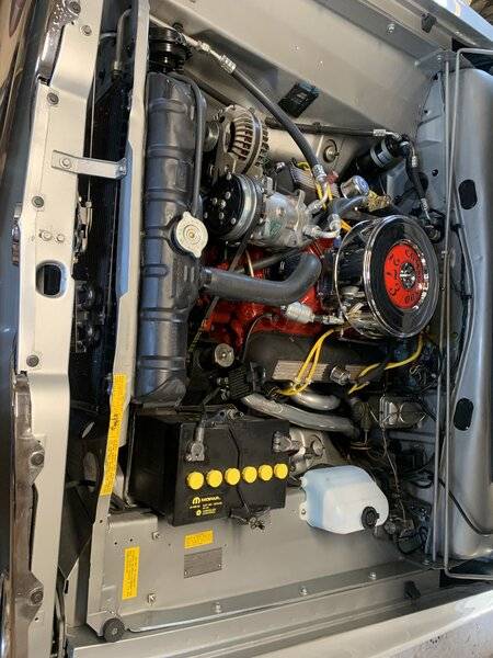

My 66’ 273 is factory front cover and cast iron water pump.
I used a Dakota v8 clutch fan assembly and it fits like it was made for it.
96’ 318 truck is what I believed was used. Also fits the factory fan shroud.
???Thought the Dakotas were screw on clutches
