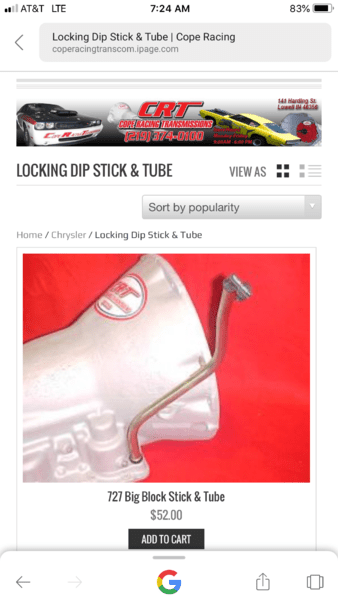

The CRT locking transmission Dipstick I got worked great. It comes with the better seal too. My 73 Dart had a 440 with Indy EZ heads and 2 inch tube TTI headers. It bolted right in and I didn’t have to bend it etc to get it to fit.
