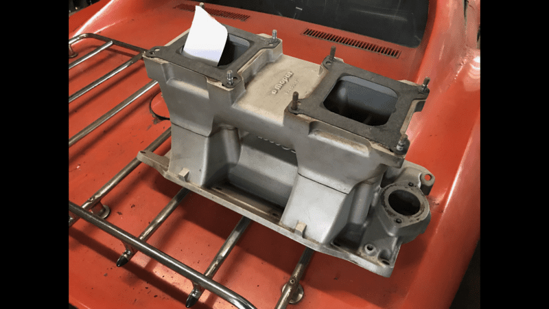

Big block low deck tunnel ram? Help.
See the dizzy cutout in the rear and coolant boss on the front? Not on B block

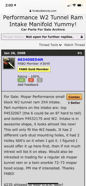

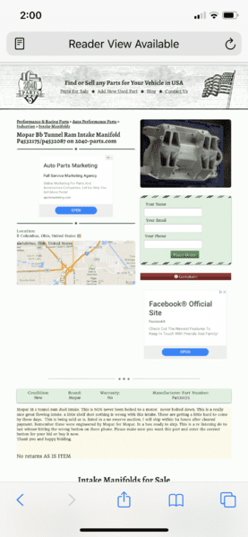

Upper part number-P4532087
Lower part number-P4532175
Before I buy is that the correct lower for a low deck B engine?
The number for the lower on mine is P4532277-2, the upper is P4532067. Keep in mind these are casting numbers and may have changed during production. IIRC the upper section is the same between B and RB, the lower part is different, my B manifold measures 7-5/8" across the bottom. HTH, Steve
That is a great price if a person needs a W2 tunnel ram. Not a good price if you need a BB tunnel ram.
