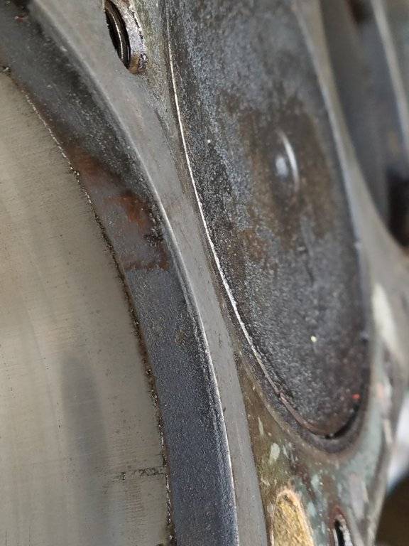

So I began to clean the second hand 383 that I bought to do a cheap rebuild on and put in my truck. I began cleaning the pistons and numbering them and when I got to the second to last piston I found that it sits WELL above 0 deck. The deck seems level and every other piston is perfectly at 0 deck. Anyone know what could cause this or what to do? I'm thinking maybe just replace that piston and rod.

I'm pulling them all. I was numbering them to get them back where they go. I need to rehone the cylinders either way.

All of the others were perfectly 0 decked. My first thought was a possible bent crank, but then I realized that that is the only one that isn't perfect.

Then I would suspect a different (incorrect) replacement piston. Measuring the compression height will verify that.

It did come with heads. They look fine and there are no valve marks on the piston. I'll pull it first to see it may have spun a bearing resulting in both the bearings somehow being on one side.

rolled and stacked bearing.
It's possible. Haven't seen that but once since 1974. Also possible is that the rod nuts have backed off. He will simply not know without verification.

I I had that engine in my shop I'd be able to tell you what the problem is. Since you have the engine in your shop maybe you can tell us why the one piston is sticking out of the block?

Just pulled the oil pan to get that rod out and foud that the cap had about a 1/4' on play where the po must have tried to pull it at some point.

If the crank is not hurt than just polish it and use it! unless you want a stroker, You can't fix it unless you know what is wrong.

The crank seems perfeclty smooth and the bearings show almost no wear (I'm still replacing them). I might get a set of aluminum heads, but don't plan on stroking this one.
