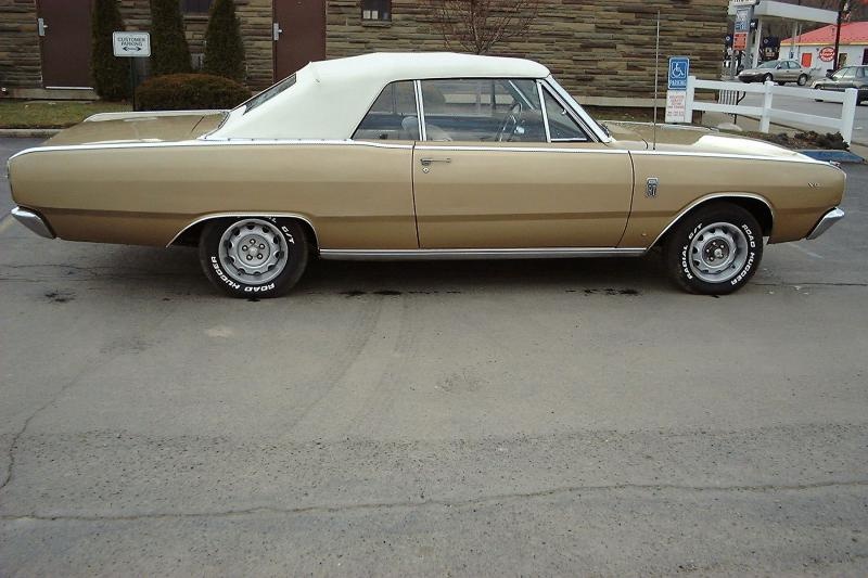

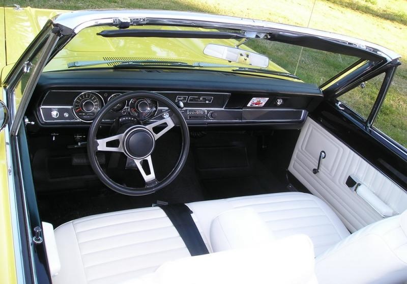

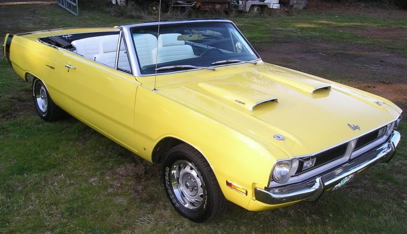

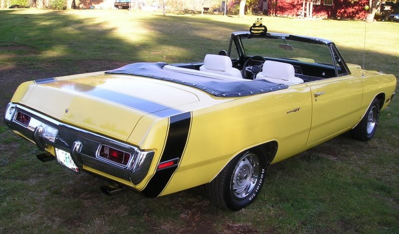

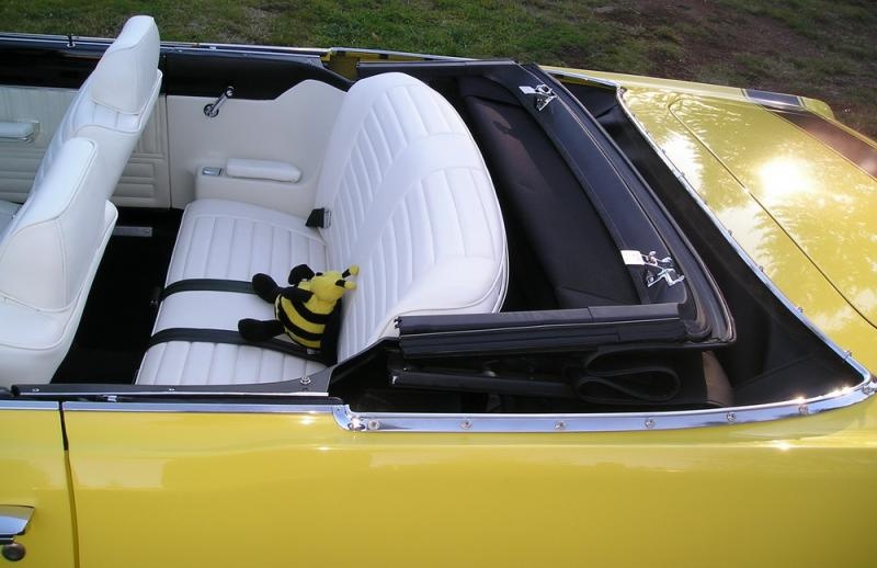

Here's a couple pic's for you!

Man I have been wanting to do that to my conv. for a looooong time. It's gonna look great like the rest in the pics above.:blob:
seen a rootbeer color 70 Vert at Mopar Nats a few years back
Too bad they stopped making the convertibles after 69, the 70 makes a fine looking convertible
Great project I'm not certain I've ever actually seen an A-body convertible in person ,they seem to be a real rarity.making a 70 + version is an even more interesting car IMHO .I'll be watching this thread!
They should have continued the convertible line into at least 70 or 71. Those 70 conversions look great!

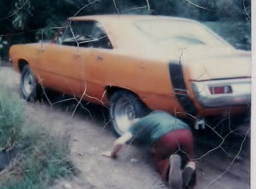

Well I did some digging and found some pictures of the past. The 70 was my first car it was real deal 340 4 speed car the 340 was long gone. Someone road it hard and put it away wet. LOL not knowing what it was worth it got junked. The 67 convetible I got from Ca. that was by far the best old car I ever had.

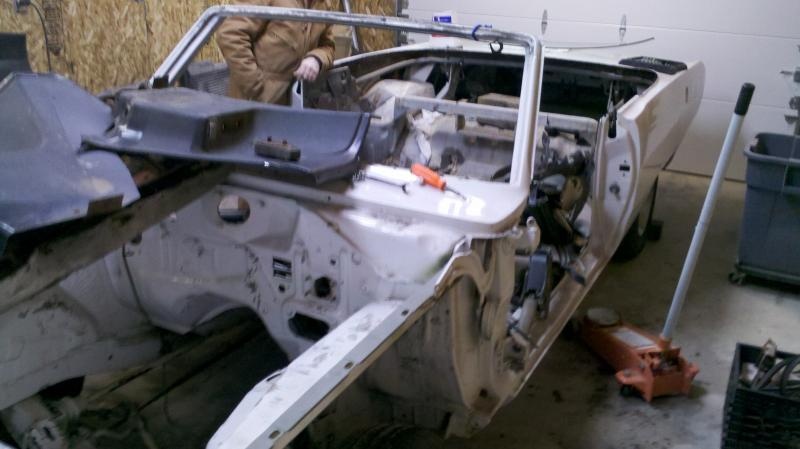

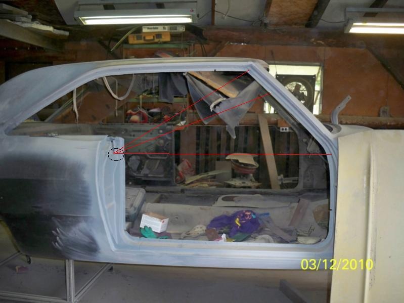

Here is the picture of the car that is going topless. I started cutting away at the conv. today I removed the right rear quarter panel trying to save it Dustin and myself didn't do too bad. Let me tell you there is a lot of a spot weld to remove to take it all apart. I think that I can take it all out in 1 piece but when the reinstall starts it will all have to come apart. I was just wondering anybody had any ideas how to measure the windshield frame before I remove it so when I install it to the same angle?
I did a 66 dart and had to replace the total front cowl section.
I measured these places to get the correct angles
and made an alignment jig to hold it there while I worked on the car
the middle and top line (5 inches from middle line is critical and all the cars (sedan, hard top convertible ) that I've measured had it in the same location my 66,65 and a 64 were all the same also a 67 & 68 measure the same(different than the 64,5,6 though. the bottom line was just to make sure I didn't flex the door opening

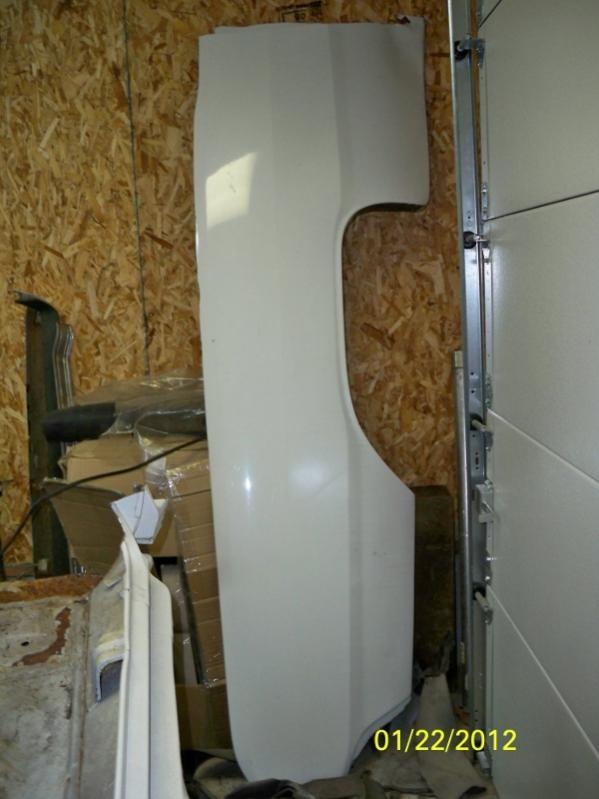

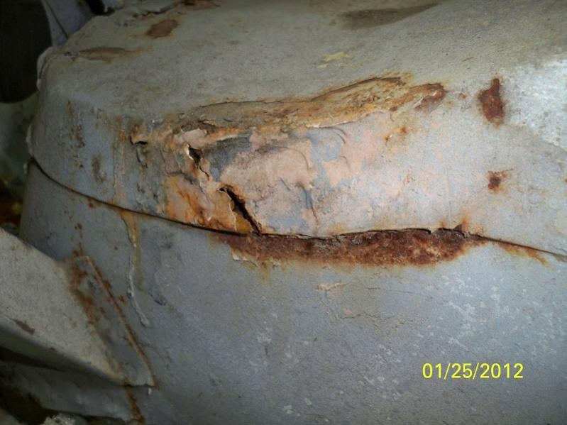

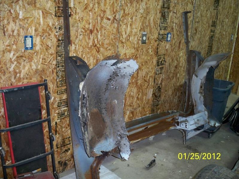

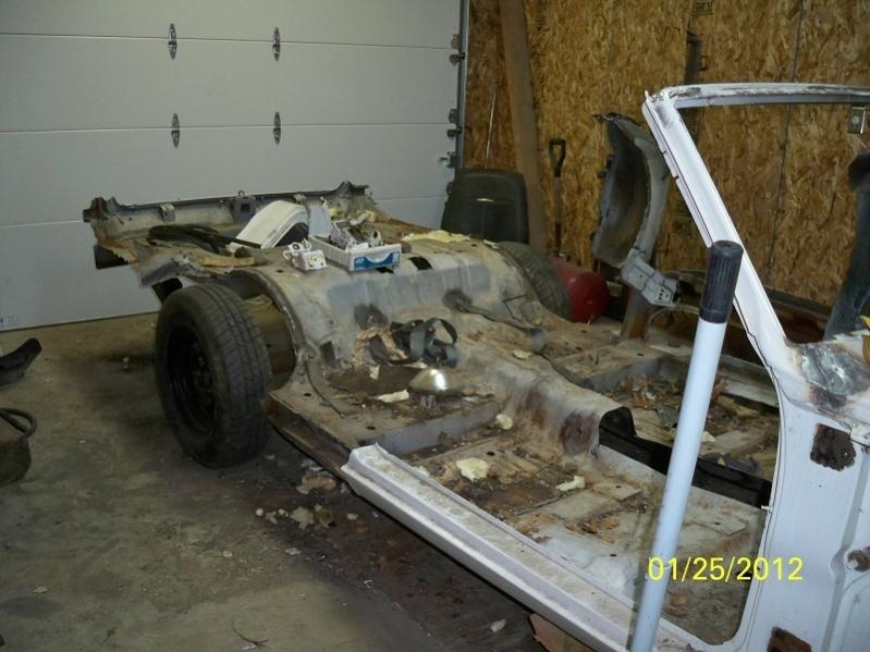

Well Dustin and myself and a saws all air chisel and spot weld cutter cut this car apart in less than a week, all that is left to remove is the windshield frame. There is a little rust in the wheelhouse cap.Now we will do the prep work to all of the pieses cleaning and painting. It went a lot faster than I thought it would.we put this car in our new garage it is so much better good lighting and heat. i'm injoying this working with my son Dustin , he is taking auto body in high school. Well it is almost time to get around for work.
