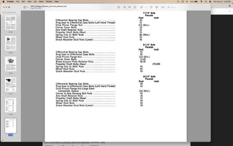

On a 8.25 sure grip what is the torque spec on the bolts that hold SG together? see pic
Thanks!
I don’t see a listing for those bolts, maybe because they are not serviceable. I would look for a 8 3/4 clutch type sure grip, and see if the bolts are similar diameter and length. And try that spec.

I accidentally loosened them while removing ring gear, was hoping for a spec but will just use bolt size torque spec.
They are 3/8 course thread. This ain't real hard. 35 LBFT with blue Locktite.

Actually on reflection, I could be mistaken. They might be 5/16 course thread, in which case they will go only about 22 LBFT, but again, this isn't rocket science and it's not hard to figure out. If my delivery upsets you so, please pretend I sent along some baby powder and a pacifier. The information I am giving you is correct for each size fastener, yet, you choose to be a pansy and be sarcastic about my delivery instead of a simple "thank you". Nobody gets paid to help people out around here. It's taken me and others decades of experience to know this stuff. We're sharing it for free. You might think about that.
