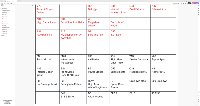

Thanks RedFish, I tracked down another import Barracuda owner and he sent me this picture, so there is the fender tag and also this Plymouth made in USA tag.
I have done some work using the fender tag from his car in some decoders and have then tried to fill in a tag as if it were my car.
I have used the pictured tag as the basis with the changes below.
I dont know the build date as I dont have that (on his tag thats C05)
I dont know the order number 000......
Added Y13 to my tag, as I know my car was ordered as a dealer demonstrator.
Added M26 to my tag as my car has wheel arch mouldings.
Deleted M31 as my car did not have belt mouldings
Replaced D6X with H6W as my trim level isHigh not Deleuxe and is white.
Replaced R6 R6 with F8 F3 as according to the previous owner the exterior was Ivy Green and the interior is Frost Green but i'm going to look into that a bit more.
Replaced X9 with F3 as the upper door frames are Frost Green
I the table I have posted the tag I have made up is in black, and the red codes are ones I'm not sure about - the UK cars had an 8.75" suregrip axle, heavy duty torsion bars and a front sway bar, but these arent coded on the pictured tag, so perhaps they are covered under Y09 for export spec and X15 for RHD?
Love to hear people thoughts.
So I think I'm pretty happy with the codes for the fender tag, having found a few other examples of UK export tags, I think the axle and suspension options etc are all part of the export spec, so dont need to be on the tag.
I've recreated the Plymouth tag using the pentastar and plymouth logos off the internet, the font was tricky, not one i had on my computer its called Trade Gothic, £400 to buy the pack, so i typed in the text I needed into an online font catalogue a word at a time and then copied it to my computer to use on the tag. Next I need to find someone who can stamp me the fender tag and print the Plymouth tag. I dont know the build date or order number for my car so I made them up as a placeholder for now.
