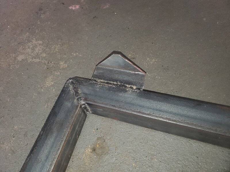

This is how far I got today, the rest of the steel won't be in untill Friday
(I moved the gussest for the uprights out because the tonneau cover is too tight to the cab right at the sliding window)

I added the hoop, just need to add something to mount the light on (2x1 angle) and some type of gusset to sturdy it up a little
