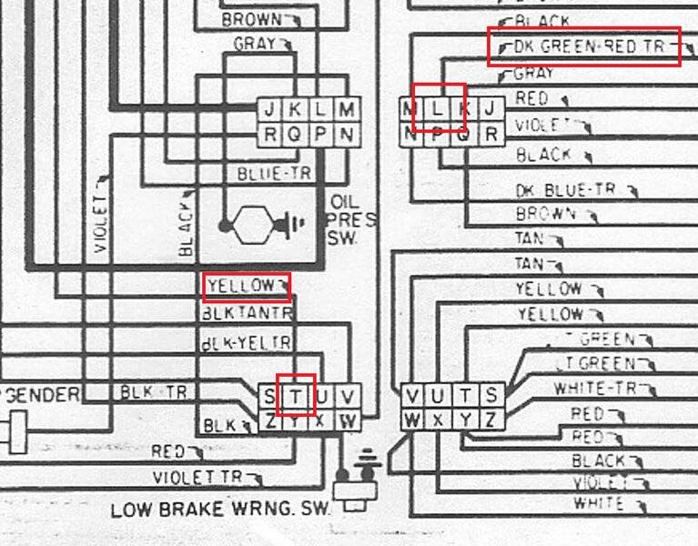

I noticed a difference between my '71 Demon bulkhead wires and the '71 Dart wiring diagram.
(I do not have the '71 Demon wiring diagram, so, I am doubtful).
On the Dart wiring diagram, the "T" connector holds a yellow wire, and the "L" connector holds a dark green w/red tracer wire.
On my Demon, it's the exact opposite.
Except for that, the wiring is the same
Is it normal?

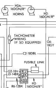

Looking at the plymouth version, the rallye instrument cluster and standard instrument harness switches the cavities for the horn and starter wires. Looking at the engine diagram, that may be a mistake in the instrument harness drawing.
Here's where it is best then to compare with what is on the car.

We're trying to say is that there seems to be an error on one of the instrument wire diagrams. The engine diagram is the same regardless of the dash option. Since these circuits connect to from the engine compartment to the passenger compartment, in this regard the rallye and standard dash harness should be the same.
However you will have to verify.
I'd do it this way.

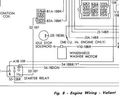

Check the engine harness to confirm S2 and H2A connector positions match the diagram.
If not, correct the diagram (and let us know what you find).
Then look at your ralley harness to be sure they match.
Only one of these is correct

T spot in the dash harness is for the green and red horn feed,
L spot in the dash harness is for the yellow solenoid feed.
The wires on the engine side connector are the same color as the dash harness wires. Line them up with your replacement harness before you install it and you'll see.
When I mapped my bulkhead connector from the wiring diagram I ran into the same problem as you. The diagram is wrong.

In fact, you're both right. The '71 Dart wiring diagram I downloaded on MyMopar is wrong :
Troy, your harness was correctly wired when I got it, but following this diagram, I inverted the T and L spots.
Now, I just have to do the opposite and invert back the two wires. :D
I checked on my Demon engine harness and in the central connector (on the L spot), there is a yellow wire. :thumbsup:
