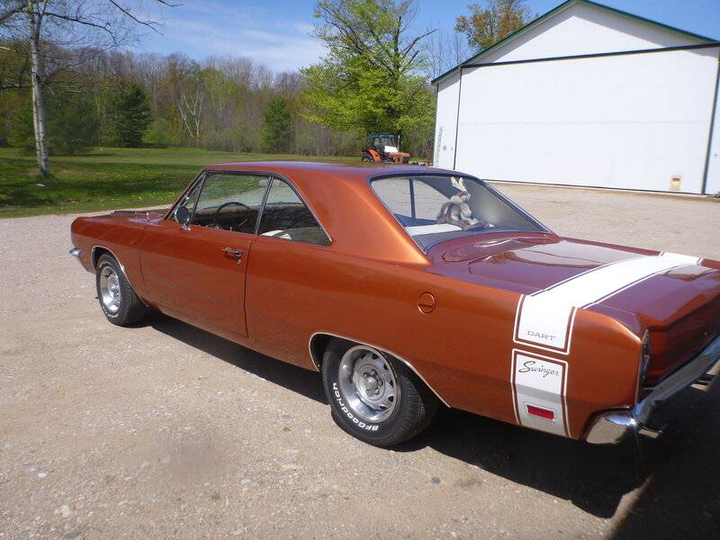

Install the side decals first then align the trunk decal to the side decals. I never installed one before I restored my Dart and mine turned out good. I used the quarter reflectors as a guide to center the side decals and worked from there, doing the trunk decal last. Not sure what you mean by spacing. Maybe someone here has a better way to explain it than I have.
If you're talking about the pin strips vs the main stripe, then the manufacturer will have that done already. It will be all one piece of vinyl backing. Agree with above. Do sides first then trunk.
As others have noted: a bit more "specific" as to your quest would help. If your quest is dimensions for painting said stripe the '69 dart decal is 1/4" wide, 1/2" space, main stripe body is 7 1/16", then 1/2" space and a 1/4" stripe. 8 9/16ths overall width. The gap between the lower quarters 1/4" decal piece and the upper 1/4" is an even 1 inch.
