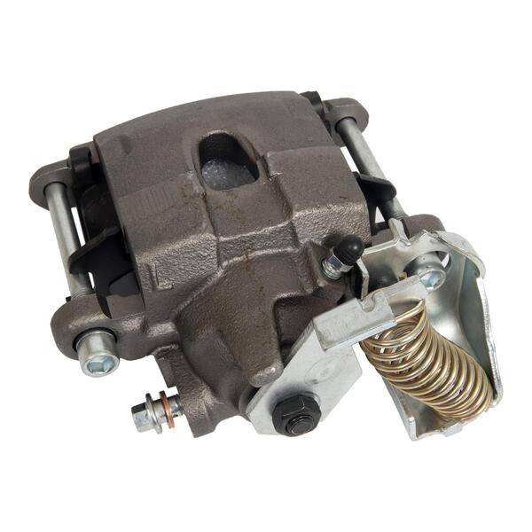

Can anyone tell me what these are ?
These were on the rear axle of my project car. I pulled them all apart to clean and paint and I need an exploded view to re assemble them .
They look like mopar front but have the park cable assembly on them.
Any help would be greatly appreciated.
A exploded view would even be better !
That may be it, But I need to find an exploded view to make sure I re-assemble correctly.
It looks like a 79-85 Cadillac Eldorado rear caliper. Common for rear disc brake conversions.
I believe you are correct ! At least it looks the same from the pic. At least something to go on at the parts store to compare with ! Thanks
