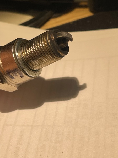

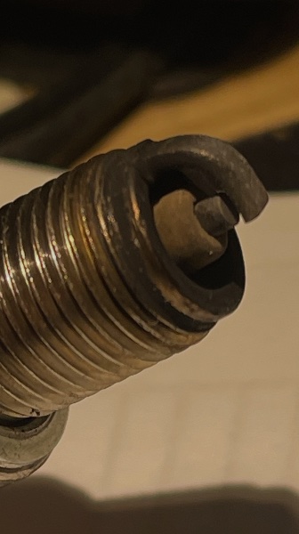

This is currently where I am at. See below. It’s hard for me to read. I see a very small amount of glazing telling me it’s hot. It looks hot. I may have too much advance in at idle. But at heavier throttle I think I am going a bit lean?
What do you guys think? Too rich or too lean?
I just got my bungs welded in so I can hook up an AFR and this will help me.
Its fat.
Take some idle out perhaps .. or maybe you are into the main circuit at idle... soooo
...what's the base/initial timing set at?
The heat range seems fine.
We need to see a close up of the tang in order to see the timing heat marks/lines for initial and full advance
Thank you. Hard for me to tell. Initially I thought that but they are not sooty more like scorched but I am no expert at all. Still learning.
I guess I should have started my last post with, put new plugs in it. Those plugs have way too much “drive around” or “idle” time on them to get any real good information from, other than its pig fat at idle.
Don’t confuse timing with idle vacuum. @MOPAROFFICIAL is talking about timing and you are referencing idle vacuum.
Thanks Ill get new plugs before I start. I will also have my AFR running as well.
I didn’t mean to randomly just throw plugs in it. You might want to get the tune up a little more dialed in before spending the money on new plugs. But, when you’re ready to read the plug for rich/lean WOT and timing, you’re gonna want new plugs.
That being said, a good tune up will clean a dirty plug up after a few runs.
