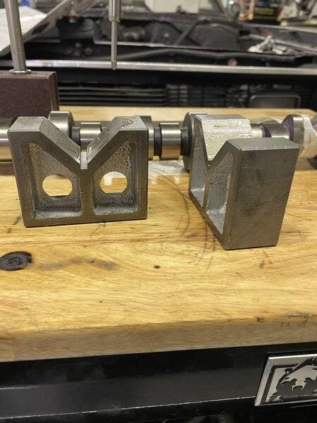

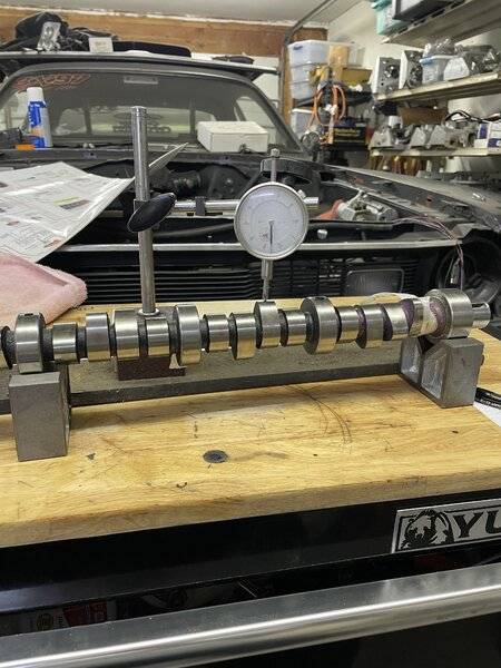

I usually try to not rush into projects so I can think on them awhile but have any of you guys made up a set of V blocks for checking valve lift. Trying to avoid putting blocks on engine stands to check valve lift on a few cams. Something of course portable that I could easily check out some big and small block cams I’d like to sell. Just to double check what I’m seeing with calipers and mics.

Wood and I Dont really get along too well. I went ahead and placed an order for the suggested V blocks above. That will save me from making something and I have other uses for them. Thanks for the ideas though.
Nice prices for high dollar inspection tool on eBay. I would not have bought them from India, but those should work for what you are doing. I have a set of home made aluminum V blocks for quick checks. I should get a used pair with clamps, either Starrett, Brown & Sharpe, or Mitutoyo.

Well the V-blocks worked out great. I ended up ordering a different set too off of Amazon due to the other set not getting here for awhile. These arrived Saturday so I checked out a couple purple shaft cams tonight. Thanks again.
