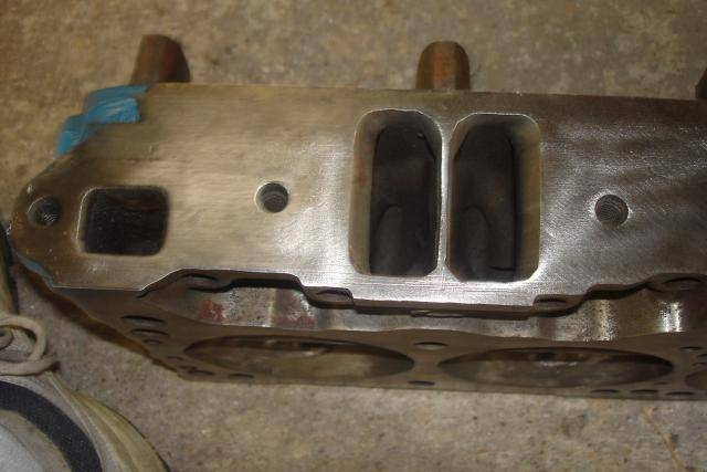

                                      My pics didn't post so when I get home here shortly I will try again to post head pics. Rumble. I boight these heads already ported so I didnt know what I had until they showed up.
                                      Rod

                                        Here are pics of the heads. They didnt attach on last attempt. DSC04962 (Copy).jpg DSC04961 (Copy).jpg DSC04960 (Copy).jpg DSC04957 (Copy).jpg DSC04956 (Copy).jpg DSC04955 (Copy).jpg DSC04954 (Copy).jpg

                                          you would have to flow them to tell
                                          running open headers or through the mufflers?
                                          I doubt slightly ported could use .600 lift
                                          does the duration give you the rpm range you want?
                                          how about a pic of a stripe on the top of the valve stem
                                          you may need a b3 kit
                                          or change heads
                                          the TF heads do not usually need a b3 kit so include that in the price info
