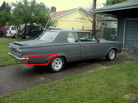

I have been looking for lower 1/4's and a member here has a 66 Dart that said he has good lower 1/4ers he could cut out and sell me.
Will the 2 be the same ?
here is the pictures of the area I will be needing, But I am not sure if they are the same, so if anyone knows I sure would appreciate the help on this :thumbrig:

Looks like I could do this, But not sure if it will be the same wheel well opening
I may be better off spending the big bucks with Laysons parts.
These 66 are a one year only and the body parts are hard to find for us 66 Valiant and Barracuda owners, I may have to have a good metal fab man make a pair this summer

Not the same in my eye's. Looks to me like the Dart body line extends from the top of the fender lip back to the bumper. The Valiant does not.
Well I sure do thank you, a member pm'ed me and said he has a pair of good lower 1/4's and I wanted to make sure before I gave him an answer :thumbrig:
Thank yall very mutch :wave:
I dont believe they are the same. I need to check the ones we have at the shop and see if they are any good
Thank you dartcuda, as you can see I used your picture :thumbrig:
I saw that. I sent you a pm.. And I believe the Valiant is more flat as the Dart is rounded and the body line on Darts are higher up..
There different Mike it's a straight forward patch to make you need to find a ol'e school bodyman to bang the patches out for you, to bad your so far i'd make them for ya !
