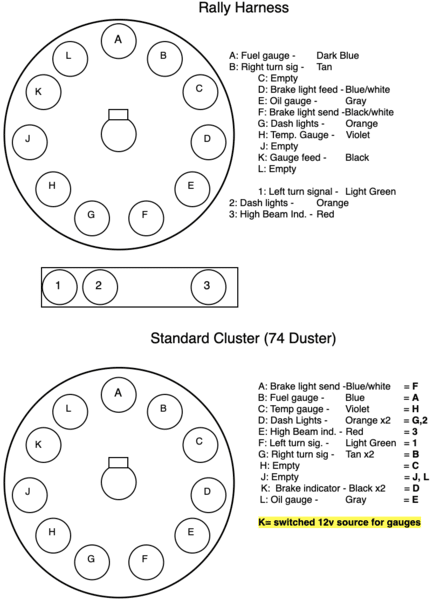

Just depends on what your plans are and how concerned about being “original” you are. The steering column and dash from a later car can be used, the dash frame will swap as a whole unit with all the later gauge stuff. Of course, you have to change the wiring to match because the plugs are not ordered the same. The steering column is a similar deal, you lose the '70 interlock stuff with a later column which is fine, but you'd have to sort out the connectors. The connectors themselves are the same for the most part, but the wires are not in the same places in the connectors.
I swapped my '74 over to a rallye dash, I used the '74 wiring but moved the wires in the connectors to match the '71 gauges. If you're motivated enough it can all be done.
