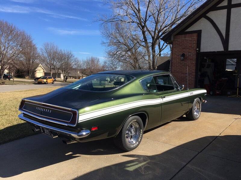

Must be A4. Yes there is a little green in there.
