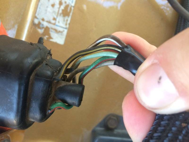

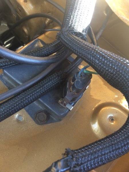

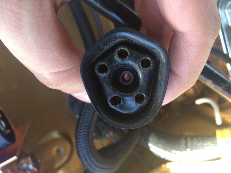

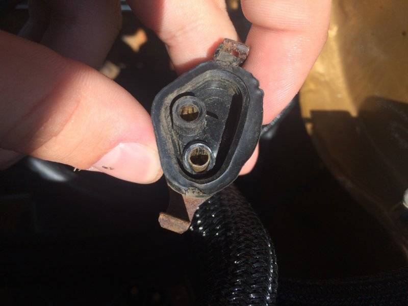

Ok so I have gone and check my wire harness and found a couple things but i have questions too. I have not check the voltage because I don’t have a multimeter to do the reading. Would the voltage regulator have anything to do with the start up ?
