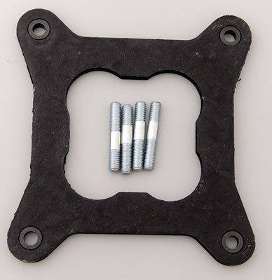

    Ever since installing my Edelbrock 1406 on top of my LD4B, I have had hot start issues.
    From the help on this website, it seems I should try a spacer first.
    Do I need a 2nd carb gasket, so it goes manifold - gasket - spacer - gasket - carb? Or, will the spacer function as a gasket on its' own?
    Thank you in advance-

    Intake, gasket, spacer, gasket, carb.
    Did you try a thick (.333) gasket alone?

      Edelbrock 9266
      Its actually a heat insulator, not spacer.
      Installs without gaskets.
      Problem solved.

        I did not try that - I actually ordered the item just below your entry! Looks like it should do the trick on its' own!

        Sweet - that is exactly what I ordered! Thank you!

        Is that listed as a heat insulator or insulating gasket?
        Regardless, that is what I used on my rides.
        Works great!

                I had the same problem. Thanks to the advice on FABO I used a Eddy 9266 and insulated the fuel lines, no more trouble!

                I believe they did, and through my research, the Ede gasket is the closest in thickness and material I could find.

                  Edelbrock 9265 for single plane intakes.

                    The 9266 gasket and insulating sleeves on the fuel line fixed mine. All the way. And that's in the hot Florida sun. Pull the intake and block the crossover if you want. But I'd try the easy stuff first and see if it works.
