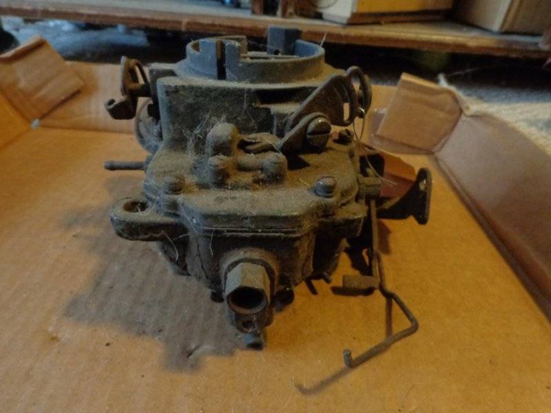

I have a 68 barracuda that I know no history on, but am pretty sure has had numerous changes/pseudo restoration.
I was rebuilding the carb and screwed it up, so I'm looking to replace it, but its not obvious to me which carb is correct/will fit, and the pictures of parts I'm seeing online don't look much like the carb I have
The one that came on the car when I bought it looks like this.

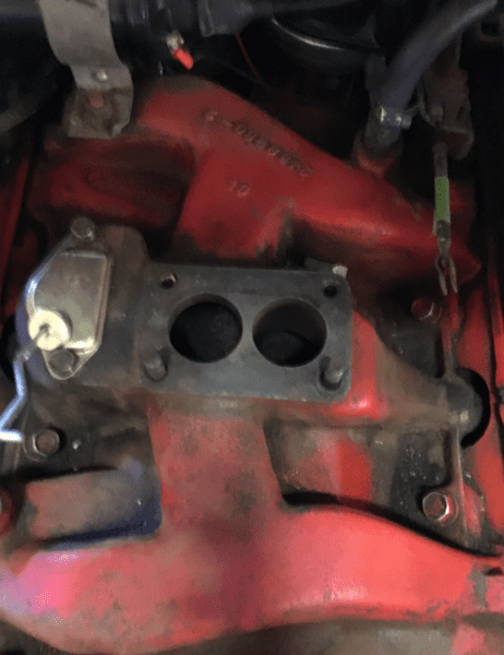

What's the carb pad on the intake look like?
Im not 100% sure what you mean by carb pad but I think this is what you want. Its a BBD for sure, not sure which specific kind.
There is another thing I'm not sure about. two of the place to fasten the old car are for bolts and the others are studs. Not sure if that's normal or not, manual wasn't too much help on that one. I kinda theorized that maybe someone had stripped out bolts and some point and re-threaded the holes and put in studs.
Yea. The one the ad is not the same as what you had or what was originally there (4420 S or 4421 S according to the book). Its more like a general aftermarket replacement for any BBD. It would be nice to know more - like who makes it and other people's experience with them.

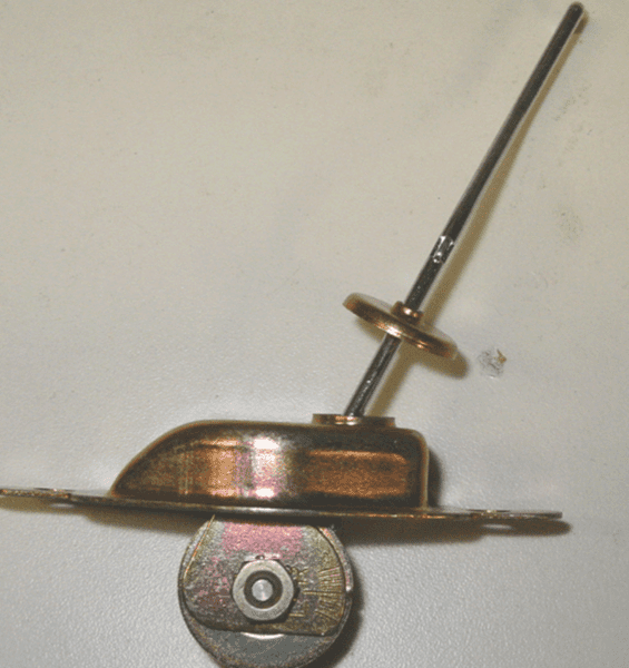

Can you show me a picture of what your choke thermostat looks like?
I ordered one on rock auto (speaking of don't trust those computer programs) once and it came in looking like this.
I had to order a different one like this.
I think they changed the style in 1970 I'm concerned if I buy that carb, the choke won't be in the correct position or wont work. Can any tell me otherwise?
All I can say is the bottom of the choke must fit a particular intake, the arm must fit a particular carb. A working choke pull off is the other part of the puzzle, plus adjustment.

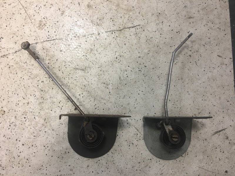

My choke is not hooked up. But I did see that my old choke thermostat rod and clip will not work on the new carburetor. My old Holley rod looks too long. I have a thermostat and rod that came off a 1975 360, I will be trying..... The stat and rod on the left are original for the Holley. Stat and rod on the right came off of my ‘75 360, and I will be trying it out today.
