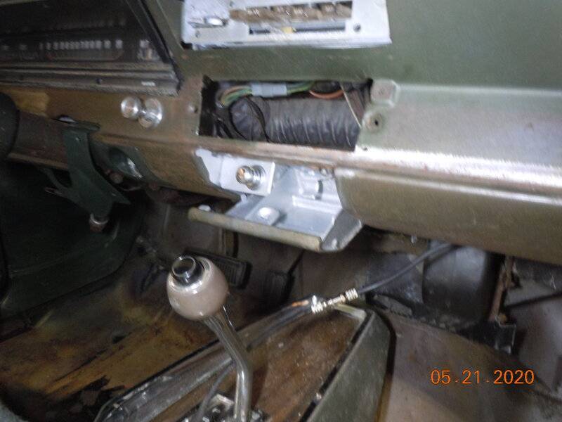

So none is exposed unless slider is open? I would fill the pits sand and paint. Argent silver looks good in my opinion. Heres dash one I blasted and spray bombed. Your skills...ez ps.

I had the same deal on my ashtray. I've used JB to fill pits before and it works great. I cleaned up my ashtray and painted the innards with Rustoleum's Hammered Silver. I really like how it came out.

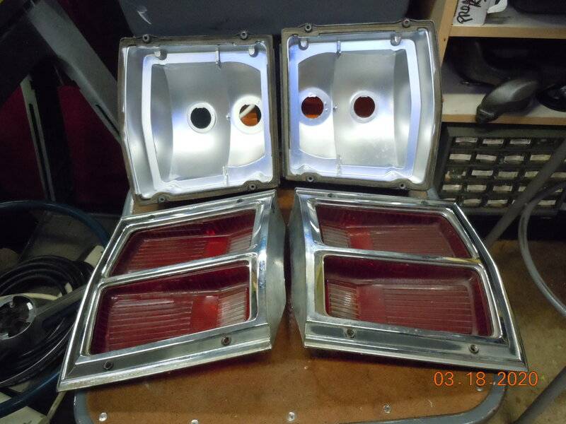

If you decide to go the chrome route, I used Rustoleum's chrome paint to do the inside of my tail light lenses. Again, I am pleased with how it came out.
