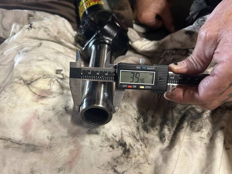

I got the tailshaft pulled today and was able to get some measurements.
Bushing ID 39.07mm or 1.5385"
Slip Yoke OD 39.46mm or 1.5535
Something looks funky with those measurements. The yoke is .015 larger than the bore in the bushing? You wouldn't be able to get the yoke in/out with those dimensions.
Sorry head up *** over here. Must be the heat....
Bushing ID 39.71mm or 1.5633"
Slip Yoke OD 39.58mm or 1.5582"
An AI search says the tolerance between the slip yoke and the bushing should be three thousandths of an inch. And if I'm doing the math correctly, I have five thousandths of an inch.
So, that's where I'm totally confused. As I stated, everything is new. I will call Denny's tomorrow and give them the OD measurements of the slip yoke. Just to make sure I have the right unit. The splines fit snug, so I'm not thinking it's an over-drive unit. If there's anything off it's just the OD not the splines.

With any luck it's a bad bushing and the new one will fix your clearance issue. While you're waiting for it to arrive, I'd take a few more dimensions. Check the bushing in a few places around the ID, 12:00 to 6:00, 2:00 to 8:00, 4:00 to 10:00, etc.. You're looking for out of round. Do the same on the yoke. Then measure the other end of the yoke as well to check for any taper in the yoke.
That's only .005" if measured correctly. That is hardly cause for a lot of slop and leakage. I would try again. Remove the seal, stick the yoke partway in, and try it with feeler gauges
