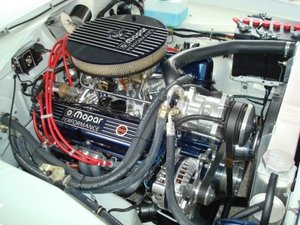

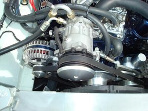

68 Barracuda with Classic air.
The classic air system: Does that come with a plate to cover the existing whole from the replaced stock heater box? That what it looks like to me?
The vintage air system: Can the through the dash connection be mounted anywhere? Looks like it could be.
The vintage air looks like the system could be made to very clean. A lot cleaner than stock.
The Classic system came with every screw, bolt, washer, every thing but the R134. I put mine in while bilding the car, but you could get it done in an easy day. No problems with the instal or unit, the glove box insert that comes with it leaves a little as far as fitment. But it did go in and is useable.
Vintage air install in my 65 Comet. Worked flawlessly
out of the box. The Barracuda will get headers instead:cheers:
