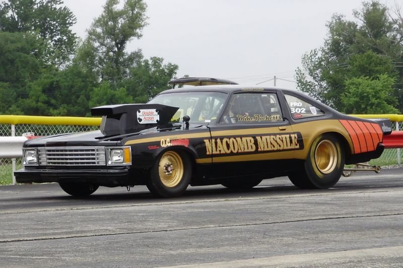

Push into neutral and click it off, after the pass ends. No downshifting. Nice setup. I've had a couple cars with them.

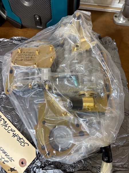

Crappy pics but this is a A&A clean neutral TB valve body I just received. Customer service was excellent, did it through emails. Emailed me back right away and answered questions that probably sounded stupid lol.
