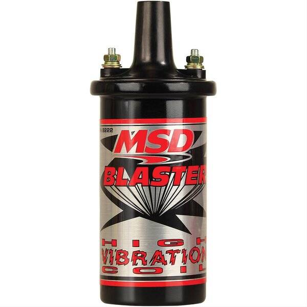

Here is a twist. MSD coil mounted standing tower up. I mounted mine laying down using factory bracket and developed an oil leak. Contacted MSD and they actually make a 12vdc coil made to lay down in Chrysler configuration. $10 more than the std coil.
The MSD 8222 Blaster Epoxy filled coil can be mounted on it’s side. I wish they would’ve had this back in the 70s.
